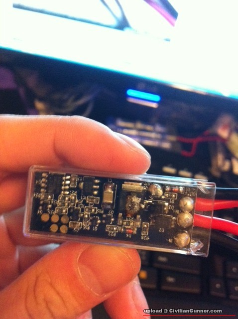

我都燒左.....換左大插打左幾野跟住開始有味同出煙...
正負又冇錯到,剪左個大插再用舊電一試,又出煙...
有冇師兄知道係軍軍軍有單係咪有得換呀?
THANKS
照片 (3).JPG (67.59 KB)
24-10-2011 01:16
有得換
咁睇非單一個別事件……係QC有問題!
佢個網址6mmproshop.com去唔到……

其實會唔會同用電有關呢?我用7.4v20c打3匣, 只係微暖, 但用11.1v20C打左半匣就有d過熱既感覺, 全部都係3連發, 樓上M16燒個支係我個Fd, 佢用11.1V35C5000mah, 試槍no problem, 但一落場打左幾下就出煙, 都係3連發
有機會架
佢標都係標到12v
大家都知11.1v出黎100%唔只12v....

但有師兄用9.6v都出事!
轉貼#9 link
Operating Voltage: 7.2~12.0V Maximum Continuous Current: 65 Amp Recommended operating battery type: NiMH 7~10 cells; Li-po 2~3 cells. (7.4~12V)
