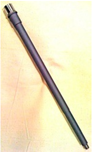

Just for your reference, the detail of Douglas Barrels: (Sport Barrels for MK12)
http://www.douglasbarrels.net/dimensions/index.html
SPECS:
Material: 416R Stainless
Length: 18 in and threaded 1/2x28
Weight: 2 lbs 6.3 oz
And the photo:
I think the A1 barrel is the most smiler (looks like) to it.
