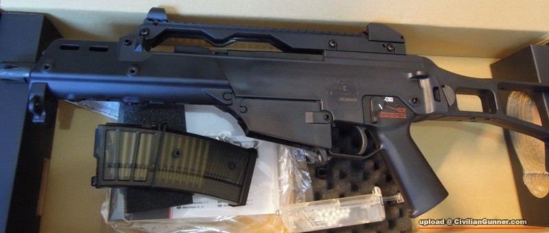

A brief open box of VFC's G36C:

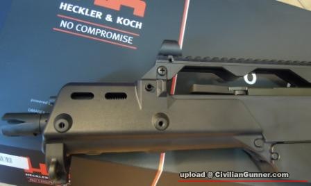

First of all, some overall photos.

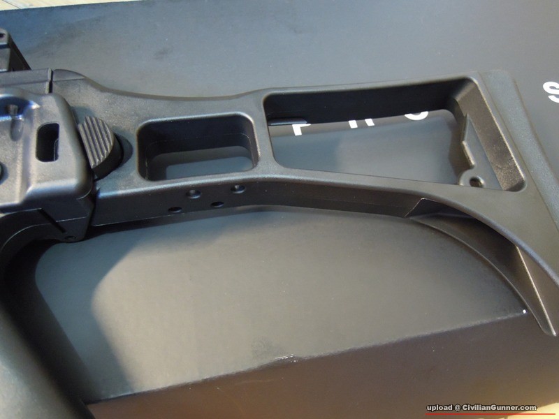

The overall gun is very light, and the plastic with the right kind of texture. Maybe during the cooling process the plastic shrink a bit, but it doesnt really matter to me at least, since real guns have that sort of marks all the time anyway (generally, i havnt touched a RS G36C anyway, they are so rare even photos are not many around). But it looks great and all the markings looks fine. every part is solid and nothing looks loose from the box.
The trigger somehow feels a little not too crisp, not like most WA m4 feel. It almost feel like a double action gun, and the trigger point is quite backwards. Once again never fired a G36C so cannot verify if this is also realistic.

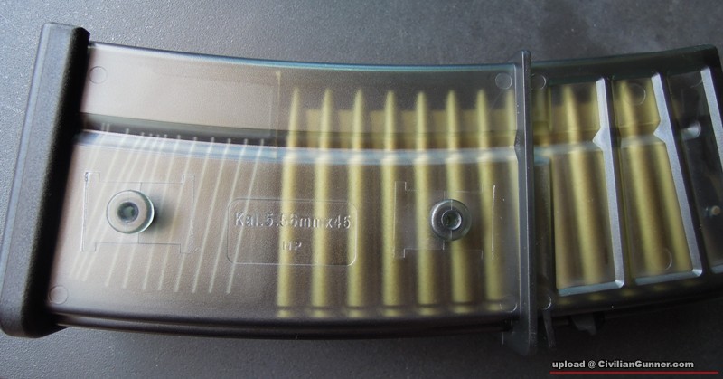

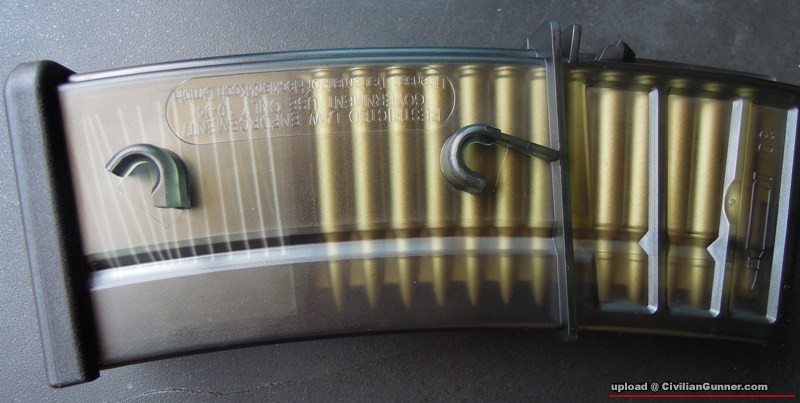

The power of the gun is 1.4xJ first shot to 1.1xJ to last shot. Mags are only 30 rounds or so, and it cleared the 30 rounds with one charge of gas at single shot.
Hopup seems ok with 2 point hopup. Test accuracy later.

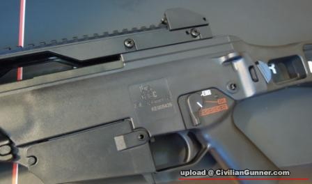

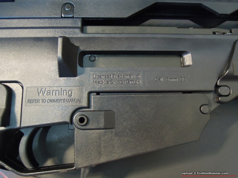

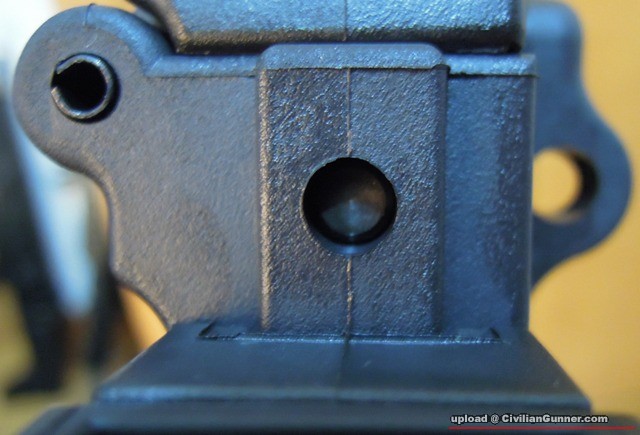

The 6mm BB cal marking.
Didnt bother me really. Because the overall quality of this G36C looks so "German" to me, I am willing to overlook this not so accurate marking. You will have it in all Uramex gun anyway. Either you buy and live with it or not, your choice.

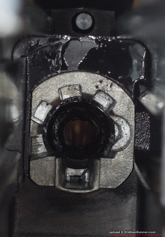

However, some potential problematic area of the internal mechanism.

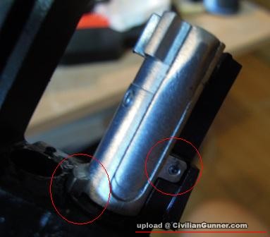

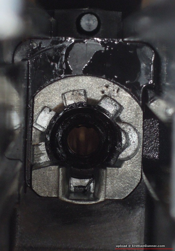

1) Metal meshed with plastic, with only pins connecting. If a BB jams, the stronger metal may cause the plastic to deform or break. Perhaps VFC can later produce a plastic version of the bolt head?

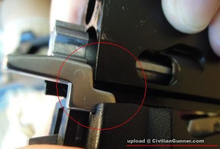

2) Bolt lock only catches a small area of the bolt, which after uses the bolt itself may deform. We will see in time if this happens.

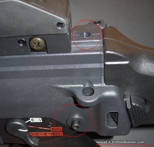

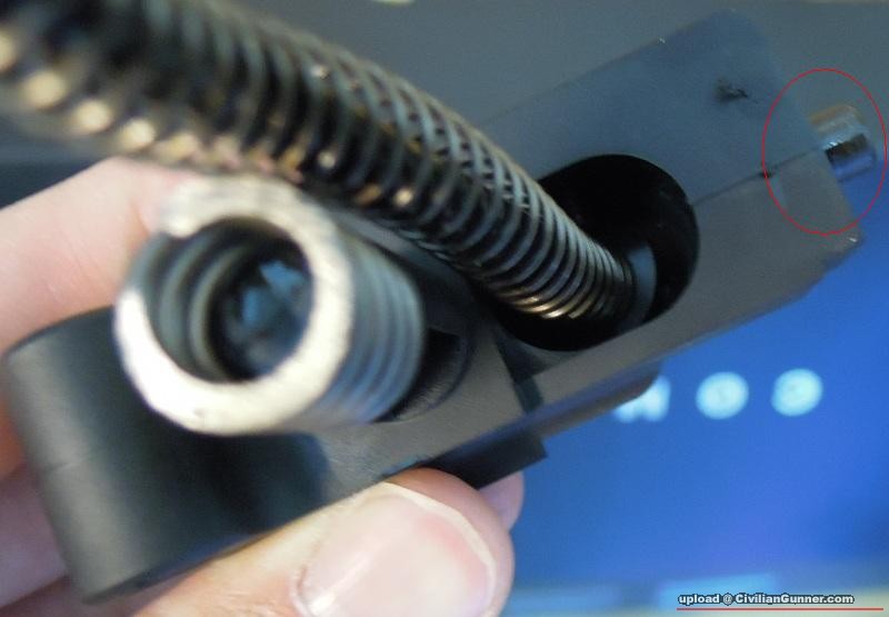

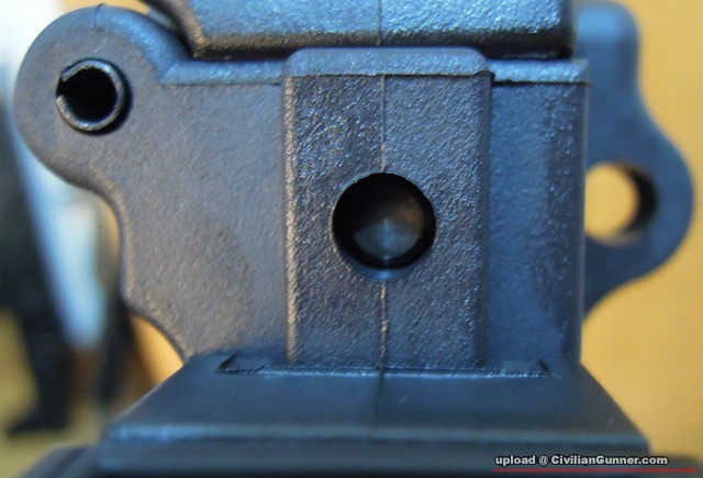

3)Finally, the end plate. This is where all the blow back takes hit, but VFC have only designed the blow back force to be taken by an insert on top, and the takedown pin below. 2 points of contact only. Also a bit worrying, but if the plastic is good enough it should be ok otherwise this is suspect able to crack.
Overall I give this gun 90 marks. -5 due to mags are only 30 rounds. -5 due to strange trigger feel.

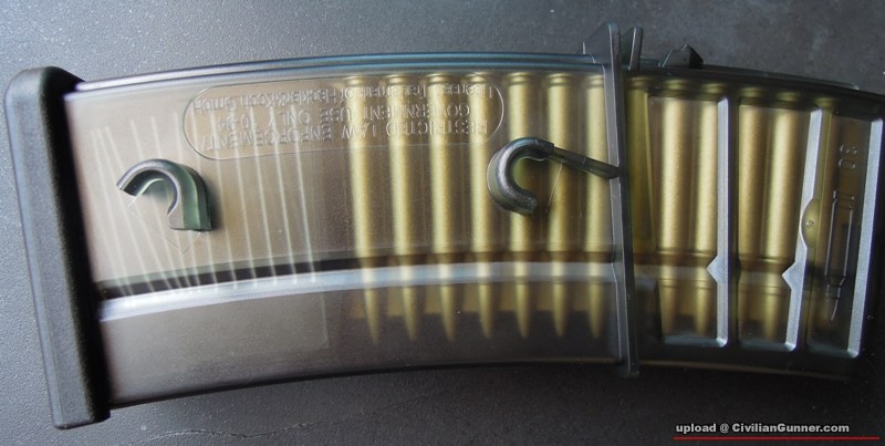

5. 彈夾實到嘔. 上夾時要暴力. 但長久用暴力係解決唔到問題既.

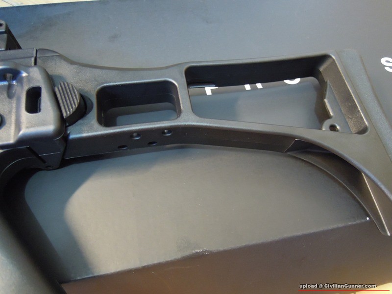

8. Folding stock 個制超更, 真係比外國人先"禁"到落去. 就算 cut 左兩圈彈弓仍然好硬, 不過好過無啦.

隻匣好似幾肉下

8. Folding stock 個制超更, 真係比外國人先"禁"到落去. 就算 cut 左兩圈彈弓仍然好硬, 不過好過無啦. <-Once again nothing wrong with this. Use two fingers. I almost twisted my thumb trying to fold it, but still i like it firm than loose.

Disagree. This is one of the best looking GBB mags in the market.

唔會喎, 個INNER GAS TAN 整得好正

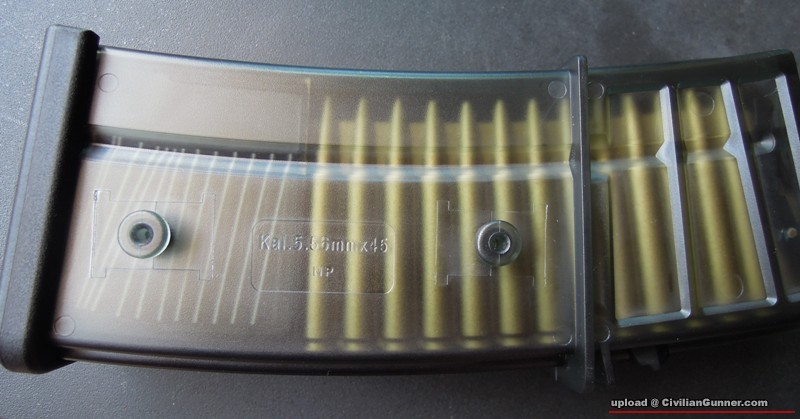

But there are some issues with the mag design itself as far as i can see. The major operation issue is that it needs time to "warm up" again after each use. AT least 5 mins i say between reloads. Common problem for plastic warped mags. Today is 33C outside and it still takes that much time for the mag to re-warm.
